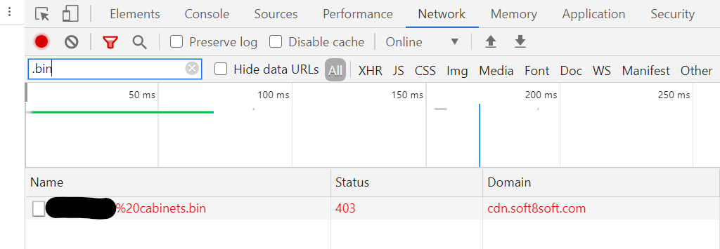

    Hi John, you are getting a 403 error (forbidden) from CouldFront when you are trying to load the bin file. This is a generic error. One reason AWS responds with 403 is when an application tries to access a file that is not in the S3 bucket.
    In this example, your file names have an inconsistent case. Your puzzles are trying to find a bin file with a lower case “c”, but your bin file has an uppercase “C”. The S3 file system is case sensitive. Macs and PC are more lenient about case. This is why it works locally for you and not in the cloud.

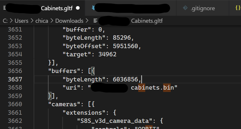

    Please check again, it is definitely a case mismatch. Internally, the gltf file is referencing “…cabinets.bin” with a lower case c. See attached. So the GLTF filename is spelled with upper case C, but internally it references the bin file with a lower case c. Somehow the case got out-of-sync. You can fix this by re-exporting the gltf/bin pair once the Blender file is properly named. The Verge3d exporter will re-create the gltf file with the correct reference to the newly created bin file.
