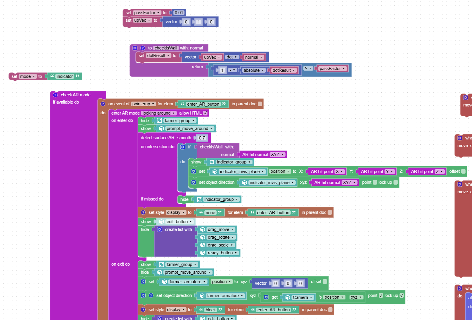

    Is it possible in verge3D AR to detect vertical surfaces?
    Such as a wall. To hang a 3D mirror on for example. Or put a cabinet automatically against the wall.
    If yes, can this detection be combined with floor detection? For example, put a cabinet on the floor against the wall?
    #60550
    Hi, it’s quite possible. Check out the AR hit normal puzzle.
