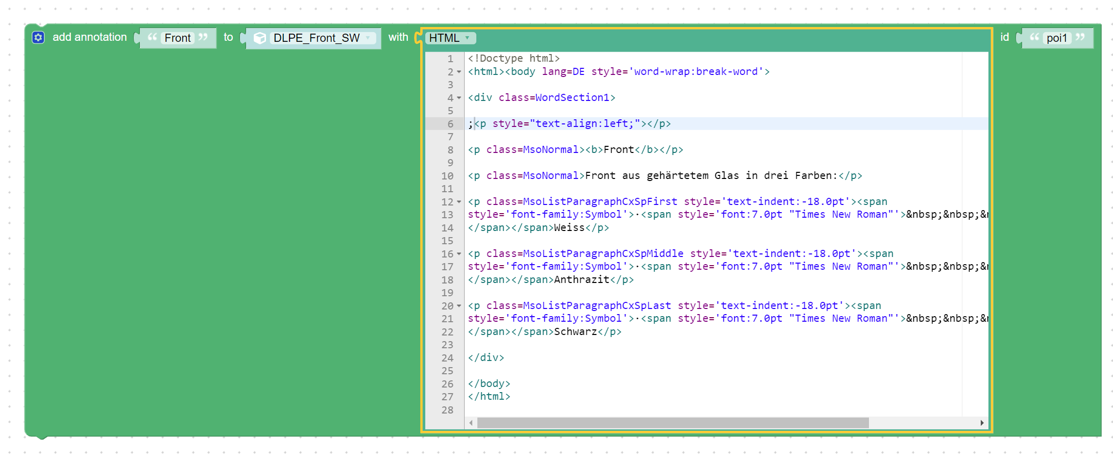

    I’m testing verge3d for my company right now, and therefore try to build some configurators. I’m more a designer, not a coder. 3D software is blender 3.x
    So I tried to add some annotations to my geometry, but they are not clickable and seem to be half transparent.
    What I am doing wrong? And is there a search function in the forum?
    Thanks, clemens
    #51377
    That mean that they inside a geometry. Move them outside.
    #51380
    tmielcl
    Hi, thanks for the quick answer!
    How do I move an annonation? I understood that they are orientated at the origin of the geometry. Can I define kind of an offset?
    #51401
    You need to move the object that is an anchor for the annotation.
    #51479
    tmielcl
    Thanks Mikhail, I moved the annotation to an empty close the geometrie. That worked.
