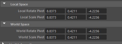

    This values must be set to 0, the engine will not Respect this values.
    It’s also better not to use any tools to make animation. Verge3D supports only direct animation of translate, rotate, and scale, we can’t grantee that animation made with any special tool will work properly.
    #79208
    gulumse716
    Thank you Mikhail. Problem solved.
