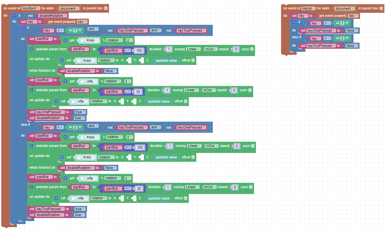

    Hi there,
    is the puzzle “updated value” only global in the scene?
    I have an example: on circle and Monkey-Object from Blender.
    I want to smooth rotate (without any keyframes from Blender) different objects in the same scene with a click (button or event).
    The problem is, only one object in the scene works with “animate param” and “updated value”.
    One object is doing a smooth rotation if i press a button.
    The other object is snapping to it´s default state and then it will rotate smoothly.
    I want to animate the value for rotation indipent for each object but with the click of one button. See here the scene:
    Verge Scene
    Here my puzzle:

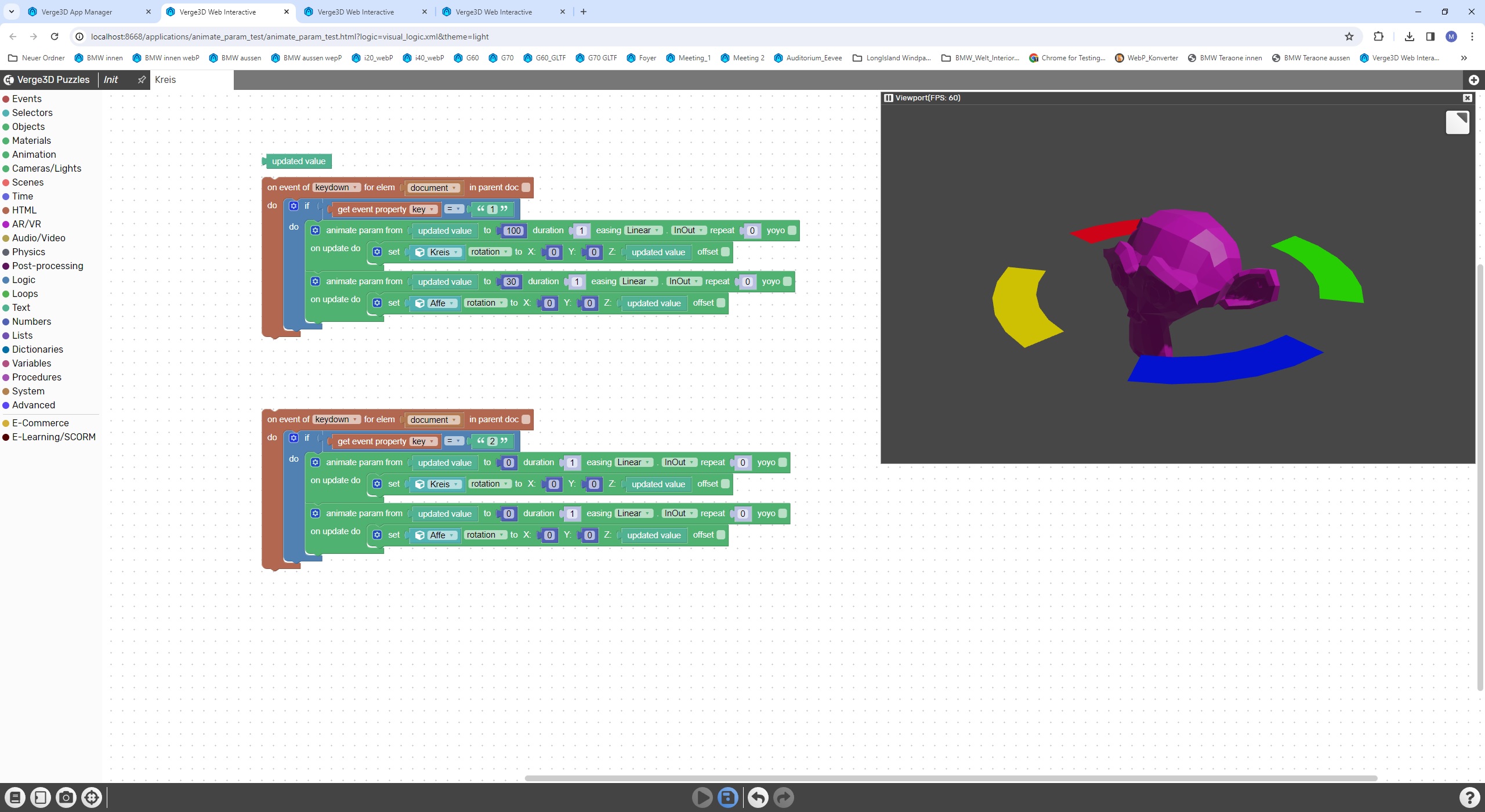

    That puzzle should be used only inside the animate param puzzle, but not as an argument for this function. It’s an auxiliary global variable calculated every frame for every animate param function individually.
    https://v3d.net/u7p

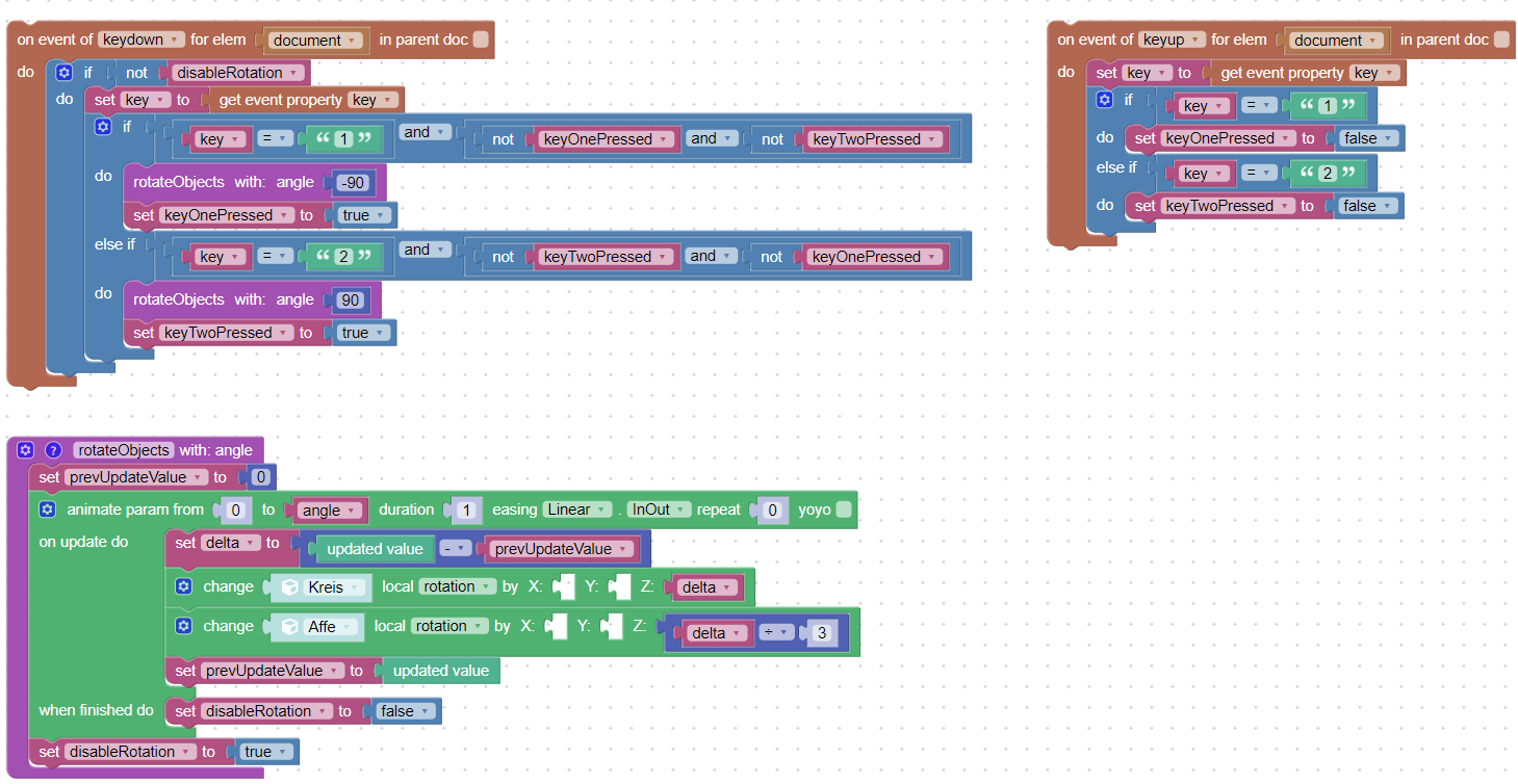

    Optimized variant (just one animate param and no repeating code)
