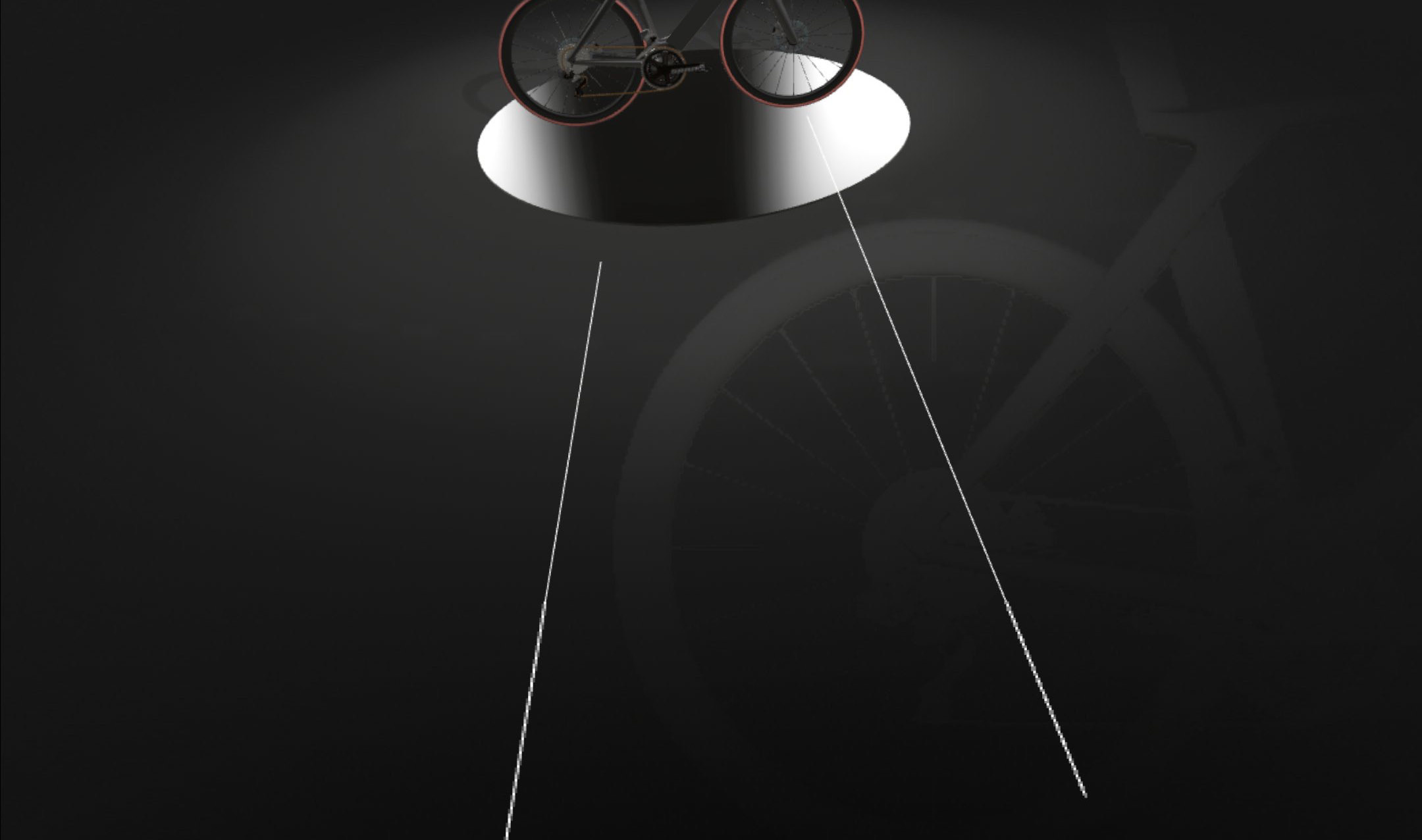

    On my Meta Quest 3 it takes much longer to load or initialize the scene and then I have something like a stencil shadow over the picture. See attachement.
    If guess a deactivation via script would work better.
    Thanks Tom

    wow, this works, it’s much better to enter the VR Mode and also this shadow is gone!
    Thank you a lot for showing the trick.
    Tom
