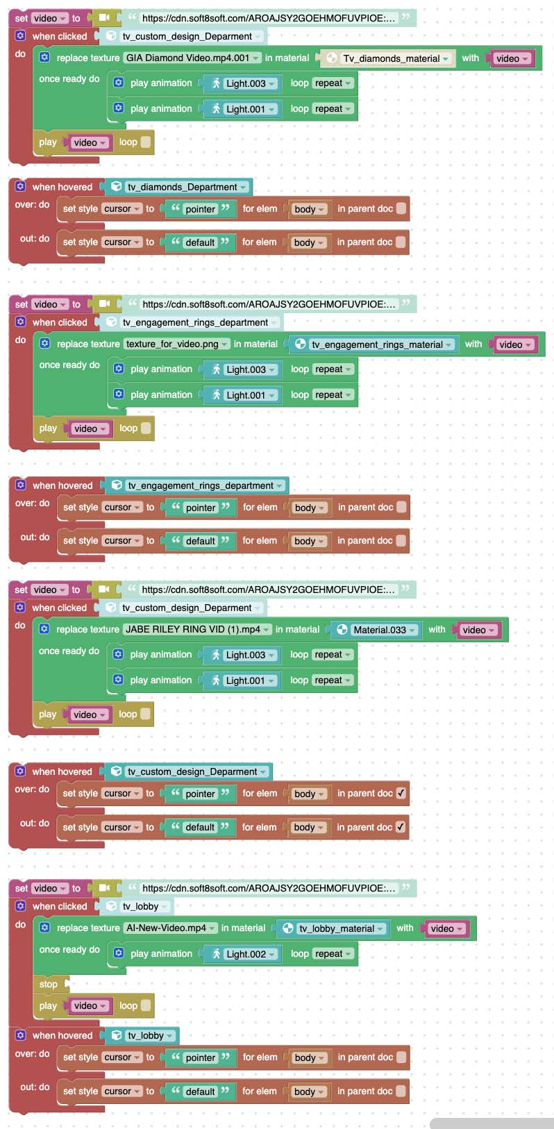

    I created a Showroom, within it are five different screens in the same scene, if i click one screen it plays a video if i move and click the next screen it continues to play the same video regardless the five different urls for each puzzles. It seems to me are sharing the same source. Is there script to add more video elements, so they do not share the same source. Basically, I want 5 different videos playing of 5 different screens within the same scene one at a time. Thank you for your help.

    Can you share the puzzles in your Init Tab as well as the puzzles you are using to control the video?

    The Issue is that regardless that i created five different tv screen, five different puzzles with five different url every screen play the same video, I did attach a couple of pics of the puzzles.

    Let me guess: they all are playing the last video defined in puzzles? And it happens exactly according to you logic (puzzles).
    #69688
    Did you try using the puzzles I provided?
    Your logic insures the result you are getting.
    Please keep in mind the variable name you are using is the same for all instances and is why you are getting your result.
