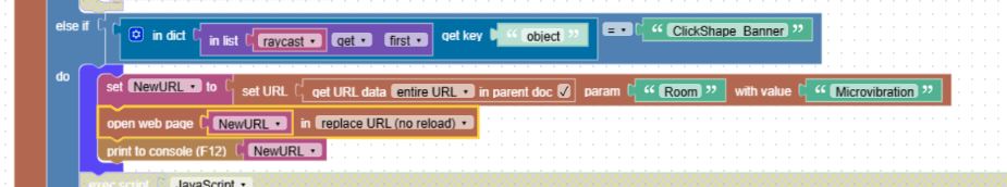

    Hello Verge3D Team.
    I’m currently working on adding a parameter and a value to the URL (without reloading the page) when an object is triggered. I’ve attached the puzzle I’m using, and it works perfectly when I’m on the myapp.html page. However, when I use an iframe and launch the index.html, the “open web page” puzzle doesn’t seem to work as expected.
    Could you please advise if there’s a way to:
    – Add URL parameters using puzzles within an iframe (index.html)
    – Read and process manual modified values parameters from the URL so that the app starts with certain events already triggered?

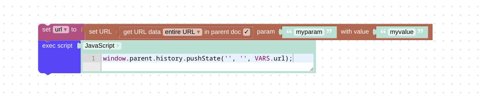

    #80023
    the “open web page – replace url” puzzle does not operate on the URL of the parent page (so it could not be used inside iframed apps). One possible workaround is to use the “exec script” as follows:

    ATGmedialab
    Thank you! This works great!
