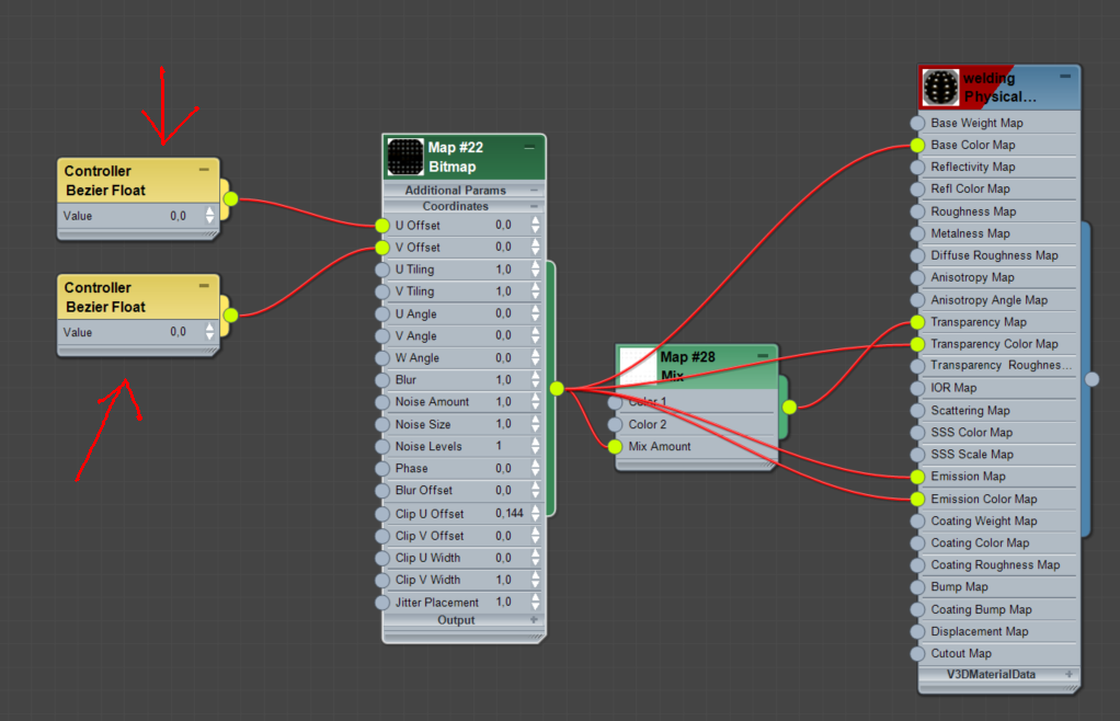

    When I was trying to imitate the solder joint animation of industrial robots, I found that verge3d didn’t seem to be able to correctly recognize the animation effect, because it didn’t have any movement, I had checked the export Settings and other issues, and I also tried to synchronize all verge3d parameters (although I knew that some parameters didn’t affect the animation effect…), but the results are still the same… :unsure: :unsure:
    #17334
    You need to use only Slate Material Editor, then add special controllers for a node you need to animate and animate that controllers not material params. See the example below.
